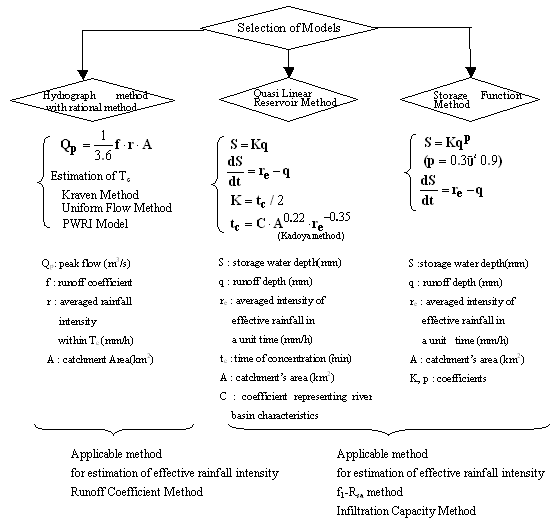

Selection of rainfall runoff model
There are three rainfall runoff models which are generally used by Japanese hydrological engineers:
- Hydrograph method with rational formula
- Quasi Linear Reservoir Method
- Storage Function Method. (see Fig. 1)
To do the runoff analysis of a specific river basin as a governmental project, one of these models should be selected under the agreement between the hydrological consultant and governmental (or local) authority with consideration of the geographical and hydrological characteristics of the basin (time of concentration, the shape of rising limb of hydrograph and etc.).
Figure 1: Selection of Rainfall Runoff Model

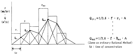

2.1 Hydrograph method with rational formula
In Hydrograph method with rational formula, unit time is time of concentration (tc). Hydrograph for every unit time is estimated by Rational Method and they are composed as shown in Fig. 2.1.
This method is used for a runoff analysis of the basins to which Rational Method is applicable.
Figure 2: Hydrograph method with Rational Formula Accumulative

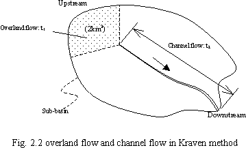

Kraven Method
In Kraven method, travel time of overland flow (t1) and channel flow (t2) are estimated separately. As for the upper area of 2sq-km in the basin, overland flow is assumed as shown in Fig. 2.2, and the travel time (t1) is assumed as shown in Table 2.1. As for the downstream from there, channel flow is assumed and the travel time (t2) is estimated with (Eq. 2.2) and Table 2.2. The time of concentration (tc) is the sum of these two values.
where tc: time of concentration (min) t1: travel time of overland flow (min) t2: travel time of channel flow (min) |

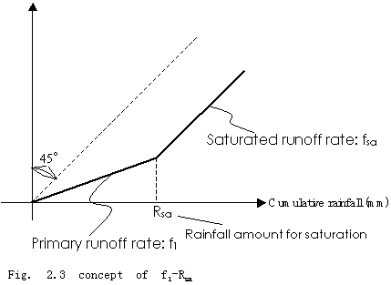

f1-Rsa Method
The concept of f1-Rsa method is depicted as Fig.2.3. In this method, runoff rate is f1 until cumulative rainfall amount reaches to Rsa , and then the runoff rate changes to fsa after that. Usually, the value of fsa is unity.
To identify the value of Rsa, the observed hydrographs of several rainfall events should be collected. The base flows of them are separated by using such method as Fig.2.4, and then the accumulated rainfall amounts and accumulated runoff volumes are plotted to a chart. Then the curving point of the regression line will show the value of Rsa.
The standard value of f1 and Rsa are shown in Table 2.5 and Table 2.6. These values can be used for first approximation.

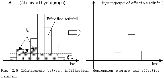

Infiltration Capacity Method
The concept of Infiltration Capacity Method is depicted in Fig. 2.5. First of all, in this method, a constant amount of rainfall (rL) is assumed to be substracted as infiltration water from a hyetograph. Next, depression storage (Ia) is removed from the early part of the hyetograph. The residue of the hyetograph is assumed to be effective rainfall.
The values of rL and Ia should be adjusted to match the shape of calculated hydrograph roughly to the observed one by calculating runoff volume (or hydrograph) for each effective rainfall per unit observed rainfall.
