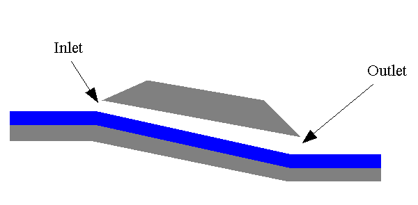

A culvert is typically used to route flow underneath a structure such as a major road, it usually consists of a an inlet structure to 'funnel' the flow into a concrete channel and then out via a similar outlet structure. Several examples and photographs of culverts are presented in Reference 1.
Figure 1 Schematic Long Section (Profile) of a Culvert

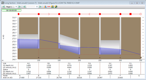

3.1 Super-critical and Un-submerged, Equation A
This example uses the network shown in Figure 2 and a constant inflow of 6.4 m3/s.
The results are presented in Figure 3.
Figure 3 Super-critical, un-submerged, Equation A

From Figure 3 it can be seen that the water depth at the downstream end of the channel (link A.1) is 1.516 m.

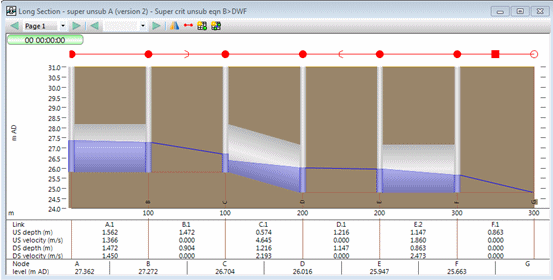

3.2 Super-critical and un-submerged, Equation B
In this example only the inlet calculations are presented as the culvert and outlet are the same as presented in Chapter 3.1.
This example uses the networks shown in Figure 2 and a constant inflow of 6.4 m3/s. Values of K = 0.515 and M = 0.667 are used, which are consistent with Table D.1 of Reference 1.
The results are presented in Figure 4.
Figure 4 Super-critical, un-submerged, Equation B
From Figure 4 it can be seen that the depth at the downstream end of the channel (link A.1) is 1.472 m.

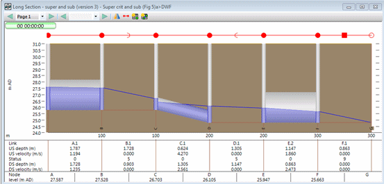

3.3 Super-critical and Submerged
Here only the inlet calculations are shown, because as mentioned previously, the headloss in the culvert itself and the outlet are calculated by the same method as the un-submerged condition. This example uses the same culvert arrangement as shown in Figure 2, except the height fo the culvert is reduced from 2.4 to 1.0 m. Therefore from equation 2:
> 4.0, therefore submerged
Therefore from equation 7 and Figure 2:
HWi = 1.728 m
From Figure 5 it can be seen that the status of the culvert inlet is 5, matching the condition presented in Table 1. The depth at the downstream end of the channel predicted by the model is 1.728 m, this matches the manual calculations.
Figure 5 Super-critical Submerged Condition

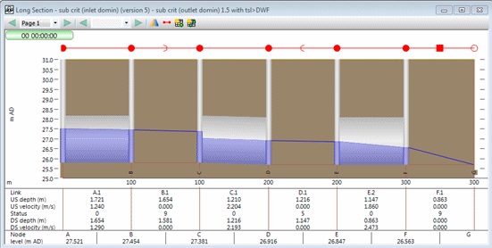

3.5 Sub-critical (Equation 8 dominating)
This example matches that presented in Chapter 3.4 except the headloss at the upstream end of the culvert (link C.1) is increased from 0.9 to 1.5. The results are presented in Figure 7.
Figure 7 Sub-critical Condition Outlet Control Dominating
The calculation of HWi is unaffected, remaining at 1.527 m.
Outlet control
From equation 9:
Therefore level at upstream end of culvert (node C) equals:
Invert + upstream depth + headloss = 25.8 + 1.21 + 0.371 = 27.381 m, which matches the result presented in Figure 7.
Therefore the velocity at the downstream end of the inlet equals:
Q/A = 6.4/(1.21 + 0.371)*2.4 = 1.687 m/s
Therefore, from equation 8:
Therefore HWo = 1.21 + 0.371 + 0.073 = 1.654 m
Now HWo > HWi and therefore HWo dominates.
The value of HWo matches the upstream depth in the inlet (link B.1) presented in Figure 7.
Note that the status of the culvert inlet is now 9.
