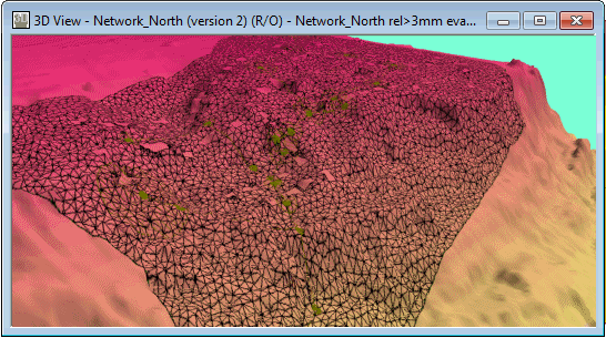

The 2D zone, alternatively described as a mesh, consists of a series of contiguous triangles, whose shared boundaries cover the catchment surface. The height of each point on each triangle is derived from a ground model GRID or TIN. An example of a 2D zone is presented in Figure 1.
2D Zone
Figure 1 - Example 2D Zone
It is significant that the 2D zones are meshed, where the size and orientation of the triangles can be varied, rather than a grid, where the layout is fixed. Meshes allow more detail and complexity in locations only where it is needed.

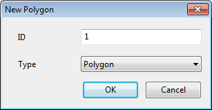

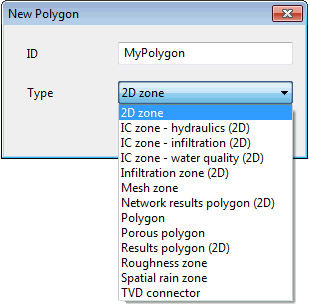

A 2D zone can be either created within InfoWorks ICM, or imported from a GIS layer using the ODIC, which is described in section 2.1.1.
To create a 2D zone within InfoWorks ICM, create a polygon by using the New Object button (New Object button) and setting the object type to Polygon in the adjacent Object Type drop down list. Choose the 2D Zone type in the New Polygon dialog. This process is shown in Figure 2. A unique ID must be specified for each 2D zone.
2D Zone Polygon
Figure 2 - Creation of a Polygon Type '2D Zone'

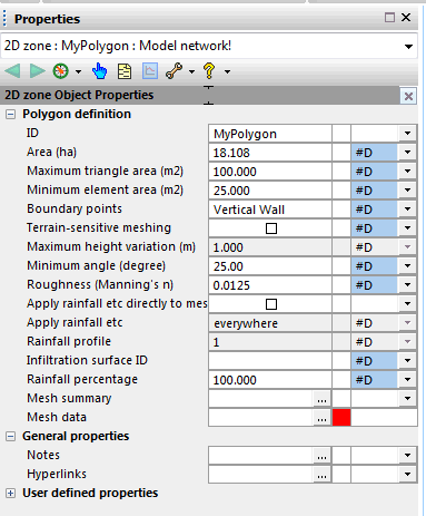

Once the 2D zone has been created, the Object Properties Window gets displayed with the properties of the 2D zone (see Figure 3):
2D Zone Properties
Figure 3 - 2D Zone Object Properties Window
  • The area is automatically calculated and should not be altered.
  • The maximum and minimum triangle / mesh element areas (Maximum triangle area and Minimum element area fields) define the limits of the Shewchuk triangles. It is suggested that an initial run is completed using the default maximum and minimum sizes. The results should then be assessed and smaller triangles (more detail) created in areas where the flood processes are more complex. These smaller triangles are created using mesh zones. The Minimum element area fields must be set to a value smaller than the Maximum triangle area field. It is recommended that the value of the Minimum element area field be set to a value not greater than 50% of the Maximum triangle area field. The 2D fluid dynamics engine groups mesh elements into conglomerations not smaller than the Minimum element area. Decreasing the minimum element area will tend to increase the run time for 2D simulations.
  • The boundary type (Boundary points property) defines what happens to the flow when it reaches the edge of the 2D zone. Five options are available: ·
    • Vertical wall
    • Critical condition
    • Supercritical condition
    • Dry
    • Normal condition
Further information is included in the 2D Zone Data Fields topic. If is it not clear what happens to the flow when it reaches the boundary, then the critical condition is recommended.
  • The minimum angle (Minimum angle field) controls the shape of the mesh elements generated by Shewchuk Triangle. Setting the angle to a small value will allow Shewchuk Triangle to generate more long thin triangles. This can be beneficial in circumstances in which the geometry of the voids is complicated and irregular and a large number of small triangles are generated when using the default value. Increasing the minimum angle will produce more equilateral triangles. The algorithm used by Shewchuk Triangle is mathematically guaranteed to converge up to a maximum angle of 33.8 degrees and can (although generally will not) converge for larger angles. However, using a large value of the minimum angle will lead to a very large number of small triangles and the process may fail due to lack of memory. In some situations, such as in the narrow gap between buildings it may be necessary to either reduce this value or the minimum mesh element area. ·
  • The Manning’s (n) roughness (Roughness (Manning's n) field) defines the surface resistance to flow. The higher the value, the greater the resistance.

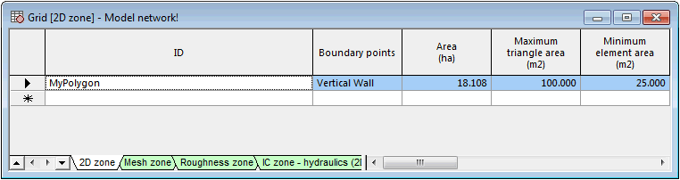

The 2D Zones can also be displayed as a grid by selecting the New polygons window button New Polygons Window.
This grid is shown in Figure 4.
Polygons Window
Figure 4 - Polygons Window

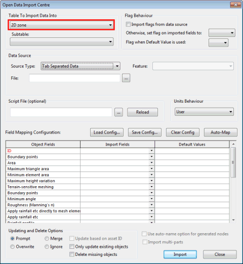

2.1.1 Import of a 2D Zone
Import of a 2D zone can only be completed using the ODIC. An example of the ODIC dialog, during the import of a 2D zone is presented in Figure 5. The drop down menu used to specify the 2D zone is highlighted in Figure 5. Once the 2D zone is specified, the object fields are automatically customised to those relevant to a 2D zone. Of these, it is only necessary to defined the ID at the time of import. Other fields can be specified later, either directly within InfoWorks ICM or using the ODIC.
Import of 2D zone using ODIC
Figure 5 - Import of a 2D Zone using the ODIC

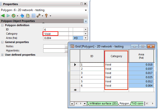

2.2 Voids
Voids define an area into which flow cannot enter. They can be used to represent features such as buildings.
Voids are used in the generation of the 2D zone triangles, described in Chapter 2.7. During this process voids from either a GIS file, a layer or an InfoWorks ICM polygon can be used.
The advantage of using InfoWorks ICM polygons is that all the data is then contained within the InfoWorks ICM database and that the ICM geometry tools can be used to clean the data. These polygons can be imported using the ODIC. Once the voids are imported, they can be simplified or cleaned up using the simplify geometry tool described in section 2.2.2.
To create a void within InfoWorks ICM, create a polygon by using the New Object button (New Object button) and choosing a type of Polygon. In the New Polygon dialog, select Polygon in the Type dropdown list. This process is shown in Figure 6. A unique ID must be specified for each void polygon.
Void Polygon specification
Figure 6 - Specification of a Void Polygon
All voids must have the same category. Any name can be used for this category, but it is sensible to call it void. Figure 7 shows the Object Properties window of a polygon for which the Category field has been set to Void, as well as the Polygons Window with several voids. Each polygon which represents a void has been given the relevant category type (again preferably called void).
Voids in Polygon Window
Figure 7 - Voids shown in Polygon Window

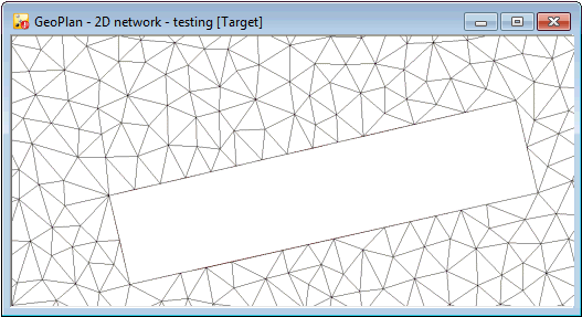

Figure 8 illustrates the effect void areas have when generating Shewchuk triangles. Triangles are not created for the areas inside the voids.
Effects of Voids
Figure 8 - Effect of Voids on Generation of Shewchuk Triangles

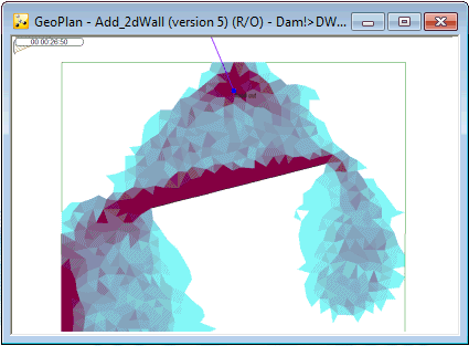

An example of the effect of a wall is presented in Figure 9.
Flow around a Wall
Flow around a wall
Flow around a wall

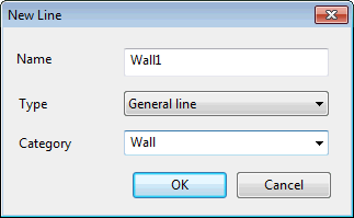

Walls and break lines, described in section 2.4, are both classed as ‘general lines’. The only thing which differentiates them is the line category. All walls must have the same category. It is recommended that the category ID is simply called Wall.
Once a line is generated, the dialog box shown in Figure 10 will appear. Select General line in the Type dropdown list. Here is it possible to select a category, using the drop down menu, or to create a new category:
New Line Dialog
New Line Dialog

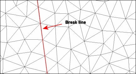

2.4 Break Lines
Break lines define lines along which the Shewchuk Triangle boundaries will be created. An example is presented in Figure 11.
Triangle boundaries defined by break line
Triangle Boundaries Defined by Break Line
Break lines are useful in defining a high or low location such as a ridge or the base of a ditch.
Break lines are imported during the 2D zone creation process, specified or edited within InfoWorks ICM and imported using the ODIC in exactly the same way as walls. The only difference is the category. Again all break lines must have the same category and it is recommended that they are simply called Break line.

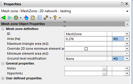

2.5 Mesh Zones
Mesh zones are polygons within which a alternative maximum triangle size can be specified. Mesh zones are usually used to specify a smaller triangle size to represent specific areas in greater detail. These are useful in areas where greater detail is required.
Mesh zones are generated in the same way as 2D Zones, described in section 2.1. The only difference is the type, shown in Figure 6, is defined as Mesh zone.
Once a mesh zone is created, its Object Properties Window will be displayed. An example is shown in Figure 12.
Mesh Zone Properties
Mesh Zone Object Properties Window
Many mesh zones, with different maximum triangle sizes can be defined within one 2D zone.

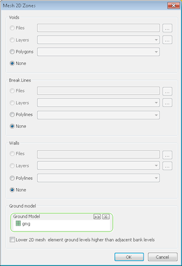

2.7 Generation of the 2D Zone Triangles
Creating 2D zone triangles (the mesh) is a two stage process. First the Shewchuk triangles are created, then a level is applied to the vertices of each triangle. The ground model is used to determine the levels but plays no part in the creation of the triangles, unless the Terrain-sensitive meshing option is used. The ground model elements do not have to be coincident with the vertices of the triangles.
The triangles are generated by first selecting the 2D Zone. Any mesh and roughness zones wholly or partly within the 2D zone are automatically selected. Meshing and Mesh 2D zones... are then subsequently selected from the Model menu. This launches the Mesh 2D Zones dialog shown in Figure 14.
Mesh 2D Zones Dialog
The voids described in section 2.1, the walls described in section 2.5 and the break lines described in section 2.7 can then be specified from one of the three sources, GIS file, Geoplan layer or InfoWorks ICM polygons.

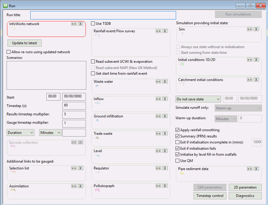

3. Running Simulations
A simulation involving 2D flooding is scheduled in the same way as a 1D simulation. The only difference is that 2D parameters can be configured via the 2D parameters button which is highlighted in Figure 16.
2D Parameters in Schedule Hysdraulic Run dialog
2D Parameters in Schedule Hydraulic Run Dialog
The 2D parameters dialog comprises four tabs The parameters associated with the General and the Advanced tabs are explained in Figures 17 and 18.
Please refer to the 2D parameters Dialog topic for information on the GPU and Steady State pages.

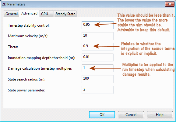

2D Advanced Parameters
Users are currently recommended to choose the default values shown in Figures 17 and 18 for all simulations.
The calculations used by the 2D simulation are presented in Reference 2. Being partially explicit they are therefore influenced by the simulation time step. The recommended timestep will vary according to the size of the mesh. For relatively large meshes, a timestep of 20 – 30 seconds would be appropriate, but for smaller meshes, 5 seconds or even less should be used. The results should be checked for mass balance errors and if necessary the timestep reduced.
The Relax tolerance from run - simulation and Relax tolerance from run - initialisation parameters are implemented by default and should be kept switched on when running 2D simulations. These simulation parameters can be accessed via the Model Model parameters Simulations parameters menu option and are shown in Figure 19.

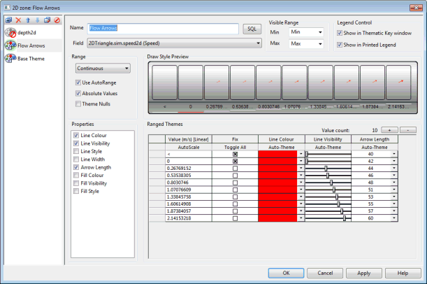

To enable arrows indicating flow speed to be viewed on the GeoPlan, open the GeoPlan Properties Dialog and click on the Edit button of the Theme column for the 2D zone. Enable the Flow Arrows theme by clicking on the Enabled / Disable Theme button button. It is suggested that a number of ranges are defined (say 10). The zero value should then be changed from zero to a small value, or the visibility of very low values set to zero so that arrows will not be displayed at very low speeds.
Arrows Theme
2D Arrows Theme
