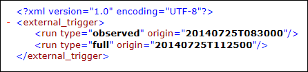

An example of an XML file is given below.
Example
For trigger files with the XML file extension, one or more simulations may be initiated by inserting multiple run elements to the XML file.
