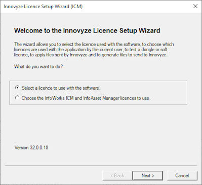

When the program is launched, the Welcome page is displayed:
The setup wizard options are:
  • Select a licence to use with the software - select the licence to be used by the current user or all users on a client PC
  • Choose the InfoAsset Manager and InfoAsset Manager licences to use - choose the licence(s) used by the current user and therefore the options available to the user in those applications
Click Next to display the next page of the wizard for the selected option.
