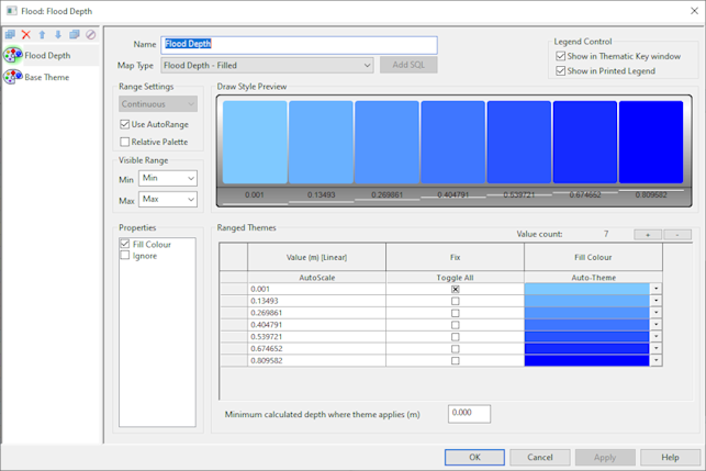

- Right-click the GeoPlan Window and choose Properties and Themes from the popup menu. This displays the Layers and Themes page of the GeoPlan Properties dialog.
- Click Edit in the Theme column for the Flood object layer. The Layer Theme Editor is displayed:
- Change the name of the Flood Depth theme (Name box) if required and select a different map type in the Map Type dropdown.
- Setup your contour parameters following the instructions detailed in the Managing Themes topic and click OK to commit your changes. See Flood Levels Theme Data Fields table below.
- Once you have set up your theme, you can export the flood contours to MIF, TAB, SHP or ASC files. See Exporting Flood Contours and Exporting Maximum Flood Contours.
The default Flooding theme is called Flood Depth and is based on flood depth. The default Map Type is Filled but other types are also available (see table below). Fill contours of flood depth values have been auto-themed so the Draw Style Preview shows a graduated set of colours going from light blue for low flood depths to dark blue for high flood depths.
Section |
Options |
Map Type |
The options available in this section depend on the type of Ground Model (Grid or TIN) being used.
Range Settings |
The only available option is Continuous. This will display the Flood Extents based on a series of ranges of depth.
Visibility Range |
The Min and Max boxes determine the map scale/zoom level at which the flood mapping is visible. |
Ranged Themes |
See Layer Theme Editor for details on how to set up themes using the controls in the Ranged Themes grid. Two important points:
The Minimum calculated depth where theme applies (m) field is used to specify the depth of the flood results at which the theme should be applied. If this value is exceeded in the results, the flood depths are displayed as specified by the flood theme. If the flood depth results do not exceed the value set in this field, the flood theme will not be applied to those depths on the GeoPlan. Default value is 0. |

Filled Contours is the most appropriate map type for visual display. If you choose Filled Transparent you will be able to see other information on the GeoPlan through the flooding display. However, this may make the colour variations in the flood display more difficult to see.
Line Contours are difficult to view on the screen. However, they may be an appropriate choice if you want to export the contours to MapXtreme or ESRI ArcGIS files.
Number of Ranges
The larger the number of ranges you choose, the smoother the gradation of colours will be but conversely, the replay will be slower.
One thing you might want to do is just display the flooded outline, without gradations for flood depth. In this case, simply select one range, with the value set to zero. Give the single range a sensible colour such as dark blue.
Fixed Ranges
You may want your ranges to have fixed values, rather than dividing the entire range of flood depths into equal portions. For instance you may want flood contour 0.5 metres apart.
To do this fix the value of the lowest and highest range. You will have to work out what are sensible values to enter.
For example, setting the lowest range to zero, and the highest range to 5, and then choosing eleven ranges, will give a set of ranges covering half metre intervals.
Alternatively you could define the values for all ranges manually, and fix them all.
