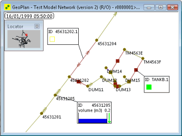

Visual feedback about the operating state of some network objects is displayed on Standard Labels.
For network objects with relevant controls, a colour coded symbol will be displayed on the label. The colour codes for the symbols follow the general rules:
  • Black - Off or No Flow
  • Yellow - Operating in intermediate state
  • Green - Design Operation
  • Red - Extreme Operation
Visual feedback is also available for some parameters; for example, level in a manhole. If these parameters are selected for display on a label a small graphic will be displayed. The graphic is updated during replay of the simulation to give feedback on the state of the network object. Parameters for which visual feedback will be displayed will have the text (Activates graphic) next to the their name on the Custom Label Settings Dialog - Content page.
