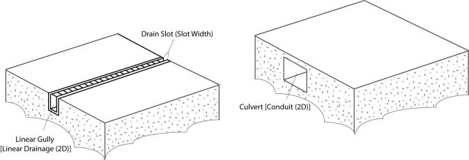

A conduit is defined as a 2D conduit if its type is:
  • Conduit (2D) - which represents a drainage structure such as a culvert, which, for example, may be located beneath a road.
    This type of 2D conduit is modelled directly in the 2D engine, which avoids the need to use a 1D network with 2D manholes/inlet/outfall nodes (which does not consider transfer of momentum) or modifying the ground model to accommodate the drainage structure using a Base Linear Structure (2D). In addition, momentum is preserved in the 2D conduit/2D zone connection, providing a better representation of the actual flow for this type of hydraulic structure.
    Tip: Alternatively, a Culvert (2D) type of conduit can be used for 2D modelling of a culvert. This uses empirical flow equations rather than the shallow water equations (see Flow calculations below) that are used by a Conduit (2D).
  • Linear Drainage (2D) - which represents a linear gully, such as a slot drain, which is connected vertically to the 2D surface.
    This type of 1D-2D linear connection can be used where the drain slot or trench is much longer than the equivalent face length of the default 2D element area defined on 2D zones. For example, the default 2D element area defined on 2D zones is 100m2 thus the equivalent face length is 15m for a triangular 2D element. Therefore, this type of conduit could be used where a drain slot is much longer, for example 50 to 100m, than the face length. Such types of drainage systems are used on roads and large infrastructures, such as airports. A typical modelling scenario which may use this functionality would be detailed drainage site projects, where the 2D modelling resolution is in the order of 100m2 or less.

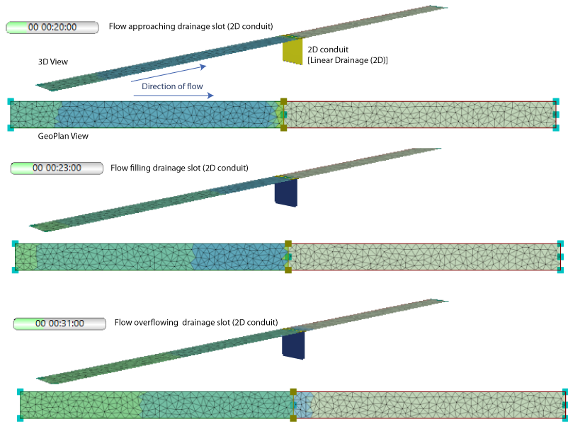

The following figure illustrates how the flow may be represented on the GeoPlan and in the 3D View when replaying the results of a simulation that includes a Linear Drainage (2D) type of conduit.
The storage capacity of the Linear Drainage (2D) conduit is included in the flow calculations which are described in the following sections.

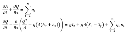

Flow in the 2D conduits is represented by the one dimensional version of the Shallow Water Equations (SWE) whose conservative formulation for the mass and momentum equations can be expressed as shown below:
(1)
where:
A is the wet area (m2)
Q is flow (m3/s)
qi is the net source discharge per length (m/s)
ui is the velocity of the ith net source discharge (m/s)
hc is the distance between the free surface and the centroid of the flow cross-sectional area (m)
hs is the pressure head under pressurized flow conditions (m)
I2 is the pressure forces due to conduit changes in width (m3)
g is the gravity acceleration (m2/s)
S0 is the bed slope
Sf is the bed friction
n is the number of source discharges

2D conduits of the type Linear Drainage (2D) are connected to a 2D Zone. 2D conduits of this type are included in the mesh and the computational cell spatial discretization is based on the faces of the 2D mesh. The computational cells are connected to the 2D surface through a slot, which acts as extra storage. The computational cells connect with the upstream 2D element of the relevant 2D face. Practically, a 2D conduit of type Linear Drainage (2D) acts like a series of point connections between 2D elements and a conduit.
The calculation of the flow exchange between the Linear Drainage (2D) conduit and the 2D surface will only begin when the connected 2D element is wet, ie, the depth exceeds the Depth threshold set in the 2D Parameters dialog. The flow exchange is calculated for each computational cell as follows:
  • If the capacity of the Linear Drainage (2D) conduit is exceeded, the excess of flow is poured into the connected 2D element.
  • If the capacity of the Linear Drainage (2D) conduit is not exceeded and there is depth in the connected 2D element, then there will be flow into the 2D conduit. If there is still capacity on the main conduit of the computational cell, the flow will be calculated based on a standard orifice equation (see Equations 1 and 2 in the Orifice Controls topic, where the discharge coefficient is set in the Vertical connection coefficient field in the conduit properties), driven by the 2D element depth. If the only capacity available in the 2D conduit is in the slot, then the slot will be filled up instantaneously with as much water as it is available in the connected 2D element.
