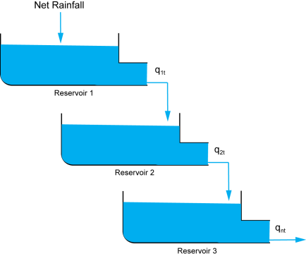

In the Cascade Routing Model, flow is routed using a specified number of linear reservoirs in series; each reservoir has the same (user-defined) time constant.
For each storage reservoir, the storage constant, K, is used and calculated as follows:
First reservoir in series:
Second reservoir in series:
..final reservoir in series:
Where: q1 is the runoff from the first reservoir q2 is the runoff from the second reservoir qn is the runoff from the last reservoir t is time in seconds I is the rainfall intensity K is the storage constant |
The linear cascade is implemented for each reservoir using a finite difference approximation.
