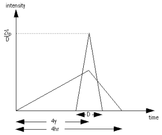

French rainfall data has never been extensively analysed for profile. Instead, alternative profiles have been suggested, including:
  • rectangular: assumes that the rain falls at constant intensity over the duration, D
  • double triangular: consists of a symmetrical central triangle with base duration D. The peak intensity is twice the average intensity over the duration D (which is strictly between 15 minutes and 1 hour).
The second triangle has a fixed duration of 4 hours. The average intensity of the rainfall through the four hours, including the profile made by the first triangle, is as defined by the equation above.
The peak rainfall for a 4 hr triangle occurs at the same time as the peak rainfall for the shorter storm of duration D. Therefore the triangle for the 4 hr storm is normally skewed. It only remains to decide when the peak of the rainfall occurs, namely at 4γ. This is at the user's discretion.
Double-triangular rainfall profile for French synthetic storms
Average intensity for duration D =
Peak intensity for duration D =

Two rainfall profiles are available for QM synthetic storms:
  • trapezoidal - the rainfall intensity increases linearly from zero to the maximum value corresponding to the constant rainfall period and decrease on the same way toward zero after the end of that period
  • double triangular - the rainfall includes a period of high intensity preceded and followed by low intensity steps of variable duration. The variation of intensity - increase and decrease - is linear.
For more information about double triangular profiles see the French Rainfall (Desbordes) section.
