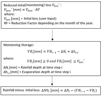

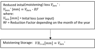

The term, moistening storage, is used to describe the amount of water required to fully moistened the ground surface at each time step. Within a continuous simulation, the recovery of the moistening storage due to evaporation needs to be taken into account. The steps for calculating rainfall minus moistening storage are shown below:
At time step i =0:
At timestep i > 0:

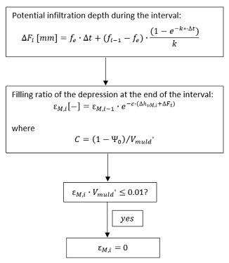

During periods without rainfall
If the filling ratio of the previous interval is zero, then the filling ratio of the current interval can also be set to zero. Otherwise, the filling ratio of the depression is related to the potential infiltration depth and the evaporation depth available for emptying the depressions. Due to the exponential approach of the depression filling ratio, the depression never becomes mathematically empty. Therefore, the filling ratio at the end of the current interval (εM,i) is set to zero when the calculated filling ratio multiplied by the reduced depression loss is lower than 0.01, as shown in the following steps:

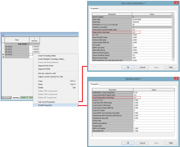

In InfoWorks ICM, the evaporation used in the DWA model can be specified in a rainfall event. If any evaporation profiles were defined on its Evaporation page, then these will be used during simulation without applying the DWA time varying evaporation factor.
However, if no evaporation profiles were defined on the Evaporation page, InfoWorks ICM will apply the DWA time varying factor, shown in Equation 2, to the evaporation rate defined for each rainfall profile in its profile properties (or the sub-event properties if you are using a global value).
