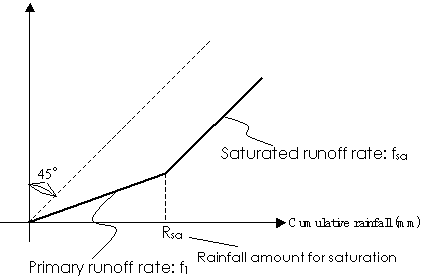

The f1-Rsa Model is used to calculate the effective rainfall when using the Quasi Linear Reservoir Method; a standard runoff model used in Japan.
See the Japanese Runoff Methodology technical paper for further information.
In the f1-Rsa method, an initial runoff rate, f1, is applied until the cumulative rainfall reaches a specified saturated rainfall value. A second runoff rate, fsa, is then applied.
Using the f1-Rsa model
To use the f1-Rsa model in InfoWorks ICM, set the Runoff Volume Type field of the Runoff Surface to f1-Rsa.
