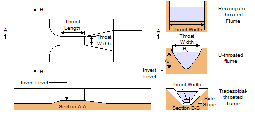

InfoWorks ICM allows you to include flumes in the network. Flumes are effectively constrictions in a channel or pipe. They are usually used to allow you to make accurate flow measurements.
Flumes in InfoWorks ICM can have one of three cross sections:
  • Rectangular - rectangular flumes are simple to construct. They usually need a hump in the middle of the throat to prevent ponding or drawdown if the discharge is above or below the design discharge.
  • U-shaped - always with a semi-circular invert (not parabolic, as often used for grit traps). U-shaped flumes are very common in urban drainage, for use with U-shaped channels and circular conduits.
  • Trapezoidal - trapezoidal flumes are useful if you expect a wide range of discharges.
You would normally expect to use a flume that has the same type of cross section as the channels or pipes on either side.

Q is the Discharge
C dis the Discharge Coefficient. This will typically turn out to be 0.95 to 0.99
b is the Throat Width
L is the Throat Length
h is the Upstream Depth
Where there is a hump in the bed at the throat of the flume, h is measured above the hump.

The above equations are appropriate for a rectangular flume (RFLUME). Trapezoidal (TFLUME) and U shaped (UFLUME) flume use the same equations modified by shape factors. These shape factors are taken from the charts in BS3680 : Part 4C : 1981.
