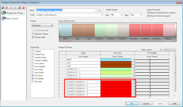

Suspect polygons are highlighted in bright red. Other overlay polygons get assigned other colours, as shown below. The original polygons are assigned the same colours by default. (In the screenshot below, cat1 and cat2, which are the categories of the original polygons, have got both the same colour).
Please refer to the Layer Theme Editor topic for further details on the different panes of the view.

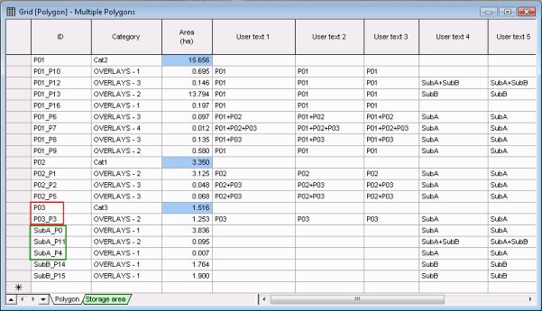

ID, Category and user-text fields for the newly created polygons
Newly created polygons are given IDs that are the combination of the original objects they derive from (prefix), and of a suffix of the type '_PX' where P stands for polygon and X is an integer.
In the screenshot below, for example, P03_P3 polygon is the only polygon derived from original polygon P03. On the other hand, Subcatchment SubA, when intersected, resulted in the generation of 3 different polygons: SubA_P0, SubA_P11 and SubcA_P4.
Newly created polygons are also given a category indicating the level of overlay. The category assigned to a polygon depends on the order objects have been selected in the Create Diagnostic Polygons dialog. User text field 1, 2, 3, 4 and 5 are used to mark the newly created polygons with the ID of objects they originate from.
If the objects to be intersected are all of the same type (e.g. subcatchments only or polygons only), the IDs of the objects a polygon originates from will be appended in the same user text field. On the other hand, if objects of different type are being intersected (e.g. subcatchments and polygons), then different user text fields will be used.

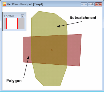

Example 1 - network subcatchment and a polygon representing a road overlap one another
| ID | Cateogry | |
Subcatchment |
SubcB |
Polygon |
Poly A |
Poly Cat1 |
Show me
- Select Geometry
Create diagnostic polygons from the Model menu. This displays the
Create Diagnostic Polygons Dialog.
- From the Create Diagnostic Polygons Dialog:
- To include the network subcatchment for polygon generation:
- Select the Subcatchment option from the Network Object dropdown list for the first overlay.
- Do not tick the Selection checkbox (this can be used if some objects are selected on the GeoPlan, prior to the display of this dialog)
- To include the network polygon for polygon generation:
- Select the Polygon option from the Network Object dropdown list for the second overlay
- Leave the Apply Themes checkbox ticked
- Click on the OK button
- Click on Yes on the message that gets displayed (Click on No if you do not wish to
save the theme as a database object, and go to step 5).
- The Common Tree Selection dialog gets displayed.
- Type in a name for the theme and browse for the desired location.
- Click on Save.
- Click on OK on the Select Properties to Save dialog.
- The theme is saved as a database tree object.
- A log file is produced. You can minimise the HTML form once you have checked that no errors were produced.
- Investigate the new polygons:
- A polygon theme based on the polygon category has been applied to these polygons

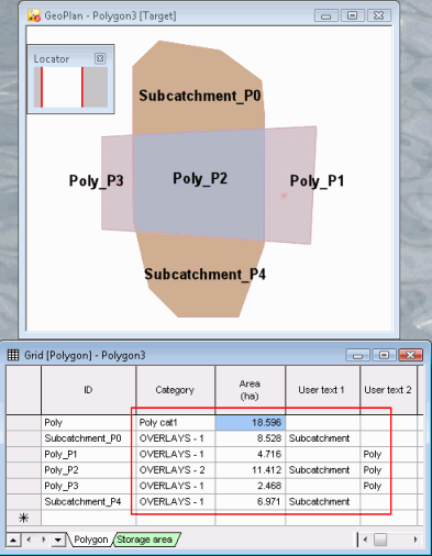

- Investigate the new polygons using the GeoPlan and the Polygon Grid Window. Five new polygons have been created:
- Newly created polygons (Subcatchment_P0, Poly_P1, Poly_P3, Subcatchment_P4) that do not result from any overlap of the original objects are given a category of OVERLAYS-1 .
- Poly_P2 which results from the overlap of the "Subcatchment" subcatchment with the original polygon (Poly) has been assigned a category of OVERLAYS-2.
- Subcatchment_P0 and Subcatchment_P4 which are cut-outs resulting from the subcatchment only have the subcatchment ID on their user text 1 field. User text 1 has been used for the subcatchment as we selected the subcatchment first in the Create Diagnostic Polygons dialog (see step 2 above).
- Poly_P1 and Poly_P3 which arise from the original polygon only have the polygon ID on their user text 2 field. User text 2 has been used for these polygons as we selected the original polygon in second position (after the subcatchment) in the Create Diagnostic Polygons dialog.
- Poly_P2, which consists of the overlap area of the subcatchment and the original polygon has been assigned the subcatchment ID of the subcatchment it originated from in user-text 1 and the original polygon ID in user-text 2.

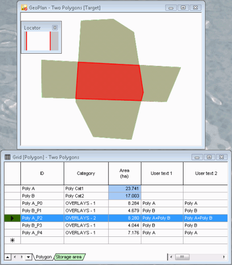

Example 2 - Two network polygons overlapping one another
This case is very similar to the previous example, except that we are now interested in objects of the same type (a polygon overlapping another polygon).
| ID | Category | |
Polygon A |
Poly A |
Poly Cat1 |
Polygon B |
Poly B |
Poly Cat2 |
As can be seen from the screenshot below, the polygon resulting from the overlap between the two original polygons has been assigned the two IDs of the polygons it originates from and these are appended in the user-text fields (Poly A + Poly B).

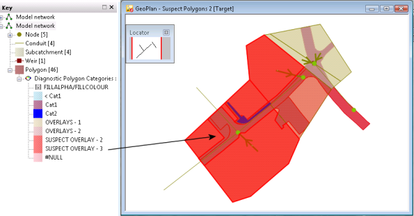

This section shows the example of an intersection that has resulted in the generation of a suspect polygon. As the Apply Theme checkbox of the Create Diagnostic Polygons dialog has been left ticked, a polygon theme is applied by default to the newly created polygons.
Suspect polygons are highlighted in red.

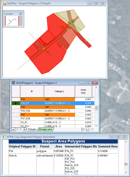

A closer investigation of the Polygons grid and the log file allows us to understand why some polygons have been marked as suspect.
Newly created polygon P34_P3 (suspect polygon in red in the screenshot above) is the only polygon originating from polygon P34 (coloured in blue / purple for the purpose of this example). Area of P34_P3 is 0.354 ha whereas area of P34 is 0.007. The surface difference being out by more than 10% of the original surface, the newly created polygon is considered as suspicious. This indicates that the user should simplify the geometry of polygon P34.

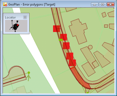

This example shows a network on which a series of error polygons have been generated. This points the user to the areas to investigate.
If you cannot easily see the error polygons on a too dense a network , you can use a combination of the log file (you can identify the original polygon IDs there) and the GeoPlan search tools to locate them on the network. Alternatively, you can modify the Diagnostic Polygon theme or any other GeoPlan theme to make the error polygons more visible or prominent in the GeoPlan. Please refer to the Managing Themes topic for further details.

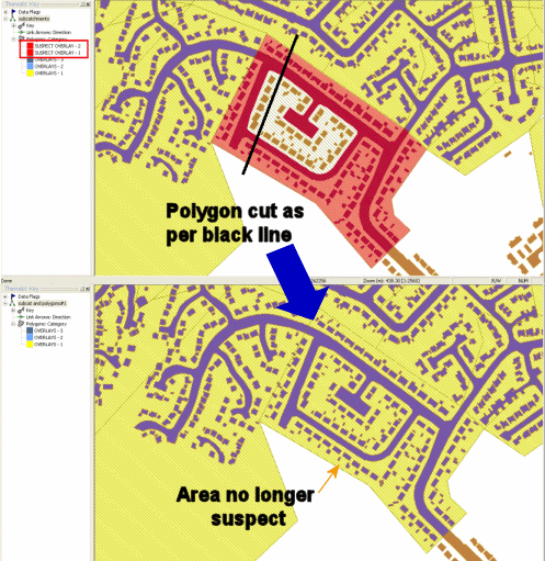

If a suspect polygon is generated and within this polygon, there is an area with no polygons, you should cut the surrounding shape.
