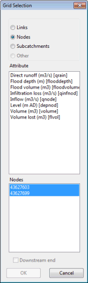

Dialog description
Item Description
Objects
The radio buttons allow the choice of which type of object is to be included in the grid.
Attribute List
Lists parameters that can be included in the grid in accordance with the object type selected using the Object Radio Buttons above.
If only one type of object is currently selected, the attribute list automatically contains the parameters for that type.
When Other is selected as the object type, only attributes common to all of the objects selected in the Object List will be displayed.
Only one attribute may be selected for inclusion in the grid.
Object List
Lists the selected objects of the type chosen using the Object Radio Buttons.
If only one type of object is currently selected, the object list contains all selected objects.
Within the list the selection can be adjusted by clicking on individual entries to deselect or reselect them.
Only the objects selected (highlighted) will be included in the results grid.
Downstream end
A check box that is only enabled if one or more links are selected.
Check this option to display results for the downstream end of links.
The default is to display data for the upstream end.
