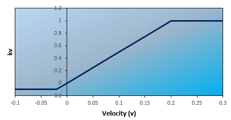

Velocity coefficient kv
The velocity coefficient defines the relationship between headloss and velocity.
For normal and high headloss types, the relationship between kv and v is presented below:
| v | kv |
| < -0.02 | -0.1 |
| -0.02 to 0.2 | -0.1 + (v - (-0.02)) * (1.0 - (-0.1)) / (0.2 - (-0.02)) |
| >0.2 | 1.0 |
