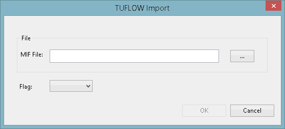

from TUFLOW network data from the Network menu, and the TUFLOW Import dialog is displayed.
- Enter the path to the MIF file to be imported, or click
to display a Windows File Open dialog and browse for the file.
- If required, choose a flag from the Flag dropdown menu. If information of the selected type is included in the import, then it will be marked with the selected flag.
- Click OK.
