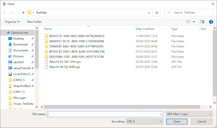

- Open the InfoWorks network to be updated.
- Select Import
Model
from XPRAFTS XPX file from the Network menu, and a standard Windows Open dialog is displayed.
- Select the .xpx file to be imported.
- From the Encoding dropdown list, select which encoding system is used in the xpx file to be imported. Currently supported systems are ANSI, UTF-8 (default) and UTF-8 BOM.
- Click Open. The import process starts and an
XPRAFTS Import dialog is displayed.
