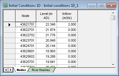

The editor consists of two grid views:
- Nodes grid - used to specify initial level and inflow values at nodes.
Initial conditions 1D can also be specified for nodes of type Connect 2D. However, you can only specify initial levels for these type of nodes. Any specified initial inflow values for Connect 2D types of nodes will be ignored.

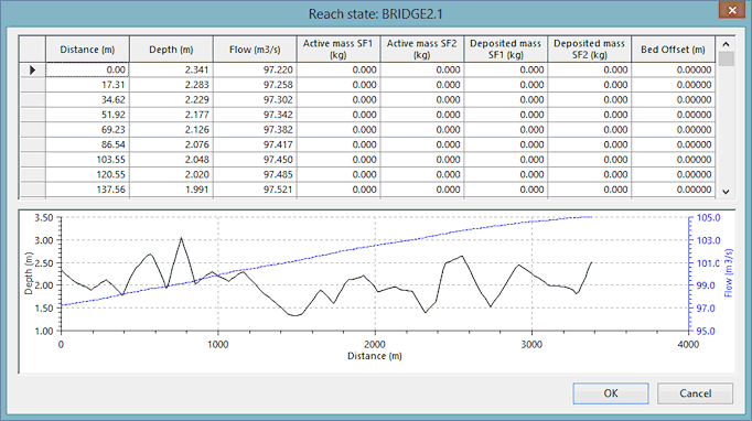

- River Reaches grid - used to specify initial depth and flow values along the river reach.
In the River Reaches grid click on the
button in the State column to display the State editor. Use the State editor to specify Distance from upstream node, initial Depth and Initial Flow values along the river reach.
For water quality simulations, active mass and deposited mass of sediment values may also be specified. The masses represent the total mass of sediment between the specified distance and the next entry in the table. Bed offset values are used for reaches that use the uniform bed updating method. (Bed offset will always be set to zero for reaches that use the invert bed updating method.)
Values can be ordered by right clicking on the Distance column and selecting Sort Ascending from the context menu.
