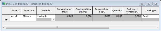

Initial Conditions 2D Grid Window
To open an Initial Conditions 2D Grid Window for editing, either drag the Initial Conditions 2D object from the Explorer window onto the main window background, or right-click the item and choose Open from the popup menu.
