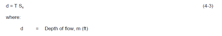

T = total spread of water and is calculated from:
d = TSx
(5)
where:
d= Overland Level - min(Ground level, Bottom storage level), m (ft)
Sx = road cross slope, m/m (ft/ft)

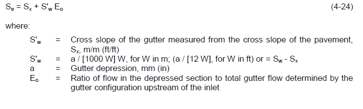

To model a depressed inlet, values for the following parameters are also required:
  • Gutter depression
  • Lateral width of gutter depression
For drowned-forward or reverse flow, either drowned weir or orifice flow is used as for the Sag Curb-opening inlet with a nominal opening height of 100mm. The undepressed weir equation is used for weir flow.

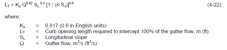

Efficiency expressed as a ratio:
(6)
where:
L = curb opening length, m (ft)
LT = length of curb opening inlet required for total interception of gutter flow, m (ft)

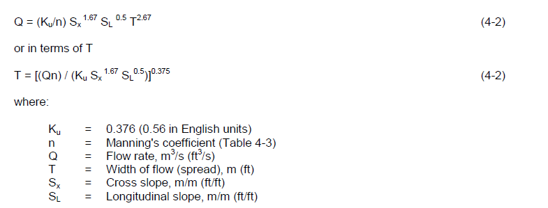

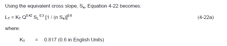

LT is calculated as:
In the calculations for continuous curb openings, the simulation engine does not have access to the values of SL and n, but it does know the values of Q, T and Sx. By re-arranging 4-2 to get an expression in terms of SL and n, we can substitute this into 4-22a to determine LT.
