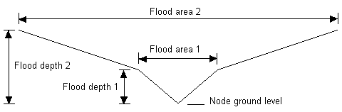

Stored flood type
For the Stored flood type, you must specify the relationship between the depth of flooding and the volume of flood. To describe this accurately requires a more detailed knowledge of the catchment topography than would normally be available. For this reason, the model uses a simplified definition of surface flood volumes, with default values provided. You can alter the default values to provide a more accurate definition if detailed information is available.
The model gives the volume of flooding at different flood depths by two conical volumes as shown in the diagram below.
The area of the cone at ground level is equal to the plan area of the node. Two depths and areas define the rest of the cone.
The parameters have the following default values:
Flood depth 1 |
1 m |
Flood area 1 |
10% of total drainage area |
Flood depth 2 |
99 m |
Flood area 2 |
100% of total drainage area |
These defaults, which are applied to fields which have the #D (default) flag set, can be altered. See User Defined Defaults for more on default values.
The system default values are appropriate for an initial flood volume between the kerb lines of a road, and then spread out to flood the entire catchment at a larger depth.
