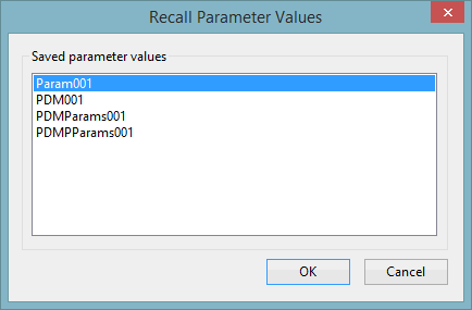

Recall Parameter Values Dialog
This dialog is displayed when you click the Recall button in the Calibrate tab.
From the Saved parameter values list, select the name of the saved parameters that you want to recall from the scratch pad.
Click OK.
The saved parameters are reloaded in the Calibrate tab parameter grid.
Note: If any of the values that were previously saved no longer fall within the appropriate maximum or minimum parameter values, InfoWorks ICM displays a message and changes the appropriate maximum or minimum parameter value so that the recalled parameters are still valid.
