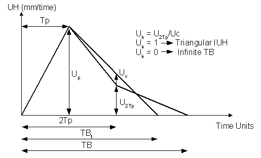

The ReFH standard instantaneous unit hydrograph (IUH) shape is a kinked triangle described by a time scaling parameter, Tp, and two dimensionless numbers, Up and Uk.
Volume under IUH must equal unity:
Rearranging:
The parameter uk is a multiplier applied to the ordinate Uc of the IUH at 2Tp:
If Uk = 1 the IUH is a simple triangle, but as Uk drops towards zero, the lost area is transferred into the IUH tail by extending the overall time base TB.
