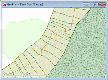

Each river bank may be connected to a single object of type River Reach, Storage Area or 2D Zone into which flow from the river reach can spill.
Flow over the bank is calculated as a flow over a jagged or irregular weir. The flow over the bank is calculated by splitting the calculation into determining flows over segments using an integrated form of the weir equation for dry, free and drowned, forward and reverse modes. These flow and associated matrix coefficients are then summed together subject to stability constraints, to give values over the entire bank.
Further discussion of this method can be found in Evans E.P. and von Lany P.H. (1983).
The geometry of the bank, discharge coefficient Cd and modular limit are defined in the river bank section editor accessed via the river reach property sheet.
The levels used to determine spill flow come from the river reach section points, mesh element points along the bank and from any computational nodes (inserted according to the space step settings in the simulation parameters).

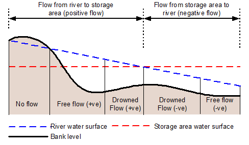

Bank flow conditions (see equations below)
River reach connected to a 2D zone and storage area

Mode 0 - Zero Flow
Condition |
The upstream (highest) water level is below the bank level defined in the spill, or the water levels are above the bank level but almost exactly equal. | ||
| Equation |
where: qs = flow over segments |
Mode 1 - Free Flow (positive sense)
Condition |
| Equation |
where: y11 = upstream water depth in river reach y12 = downstream water depth in river reach y21 = upstream water depth in bank connection object y22 = downstream water depth in bank connection object m = modular limit b = length of bank Special CaseWater surface nearly parallel to bank (y12 ≈ y11) qs = Cd b y11√y11 |
Mode 2 - Drowned Flow (Positive Sense)
Condition |
| Equation |
where: D = y12 dy21 - y11 dy11 A = Cd / yk 2 √(1-m) yk = y12 - y11 - y22 +y21 yi = y12 - y11 dy21 = (y12 - y22) 3/2 dy22 = (y12 - y22) 5/2 dy11 = (y11 - y21) 3/2 dy12 = (y11 - y21) 5/2
Special CasesThe following special cases may occur:
qs = -½ A b yk 2 (y11 + y12)√(y11- y21) qs = - 2 A b yk 5/2 {y11/3 + (y12 - y11)/5} qs = -½ A yk 2 (2y11 + yi + yk y11/ym)√(y11- y21) where: yk= y12 - y11- y22 + y21 ym= y12 - y21 yi= y12 - y11
Note: The derivatives for the drowned weir equation approach infinity as the head difference over the bank approaches zero. This may result in the solution oscillating around zero head difference. In order to avoid oscillating flows as the head difference over the bank approaches zero, linearised flow equations will be used when the head difference at both ends of a segment is below the Drowned bank linearisation threshold specified in the Simulation Parameters (0.01m default).
where: y1 = upstream depth y2 = downstream depth dhlin = linearised head threshold |
Mode 3 - Free flow (Negative Sense)
The same formulae apply as for mode 1 but with y21 interchanged with y11, and y12 interchanged with y22.
Mode 4 - Drowned flow - (Negative Sense)
The same formulae apply as for mode 2 but with y21 interchanged with y11, and y12 interchanged with y22.
