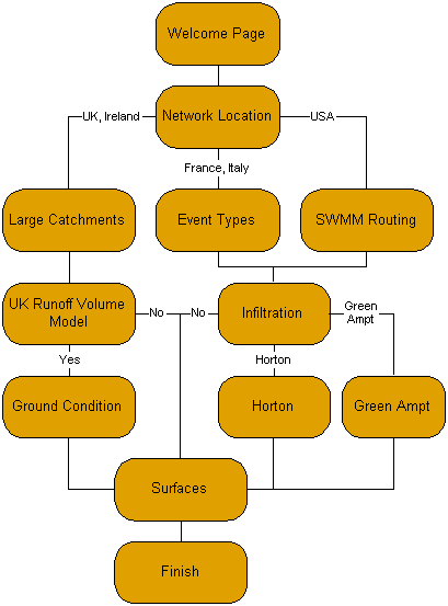

The image below shows the structure of pages in the Runoff Surface Wizard. When you click the Next button, you will move down through the structure. If the next page depends on a choice you make, the choices are marked on the links between boxes. Clicking Back will move you back up to the point you came from.
Runoff Surface Wizard structure
The pages in the wizard are described in the following sections.
