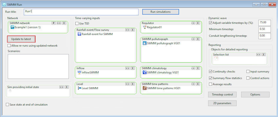

This view lets you to schedule one or more hydraulic simulations for a SWMM network and is displayed:
- when a new run is created (right-click on a model group and select New
SWMM
SWMM Run)
- by opening an existing run (right-click on a run and select Open)
An example is shown below:
To run simulations, click on:
- Run simulations - if this is a new run
- Run changed simulations - if updating an existing on-premise run
- Re-run simulations - if replacing an existing on-premise run or a failed cloud simulation, or one whose results are unavailable
The total number of hydraulic simulations performed in a run is dependent on which items are specified in the SWMM Run view. The maximum number of hydraulic simulations generated will be:
Number of Time varying events (Rainfall events/Flow surveys or TSD objects) x number of Scenarios
The items included in the SWMM Run view are described in the following sections and information about how to create a new run or re-run an existing one is contained in the Runs topic.
Dialog description
Run title and button
| Item | Description |
Run title |
The name of the run. If the entered title already exists, exclamation marks (!) will be appended to the run name until a unique name is created. If a title is not entered, a unique title of the form r0000012 will be generated for you. |
Run simulations Run changed simulations Re-run simulations |
Enabled when current settings in the Run view are valid. Starts the run simulations process. Note: The name of the button is context sensitive, and therefore may change to reflect any modifications made in this window.
Network
SWMM network |
Select an SWMM network by using one of the following methods:
If the network contains uncommitted changes, the most recently committed version of the network will be used when running the simulation. A simulation can not be carried out if the network has not been validated. |
| Update to latest |
A red border around this button indicates that there is a more recent committed version of the selected SWMM network available. Click Update to latest to update the selected SWMM network to the most recent committed version. |
| Allow re-runs using updated network | Check this option to allow simulations to be carried out for different versions of the same network without creating a new run each time a different version of the SWMM network is selected. |
| Scenarios |
If the currently selected SWMM network has scenarios, the scenarios will be displayed in the Scenarios box. Check the scenarios for which simulations are to be run. To select multiple scenarios, use the CTRL or SHIFT keys. Click on the check box of one of the selected scenarios to set the status of the check boxes of all selected scenarios. |
