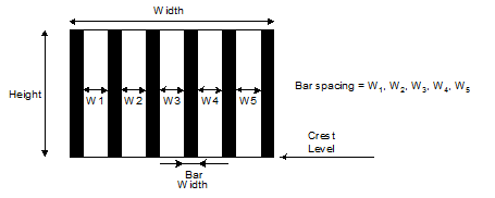

InfoWorks ICM allows sloping bar screens to be included in the network. A screen is used to trap debris in the network, possibly at the entrance to a treatment works.
The calculation method uses the Kirschmer formula, which is appropriate for clean screens, and calculates headloss due to the bar screens only. It does not replace or include for the significant headlosses that would be associated with changes in channel geometry/bed level.
For screens that are partially blocked it may be more appropriate to use a User-Defined Control and define a Head Discharge Table to represent the screen.
