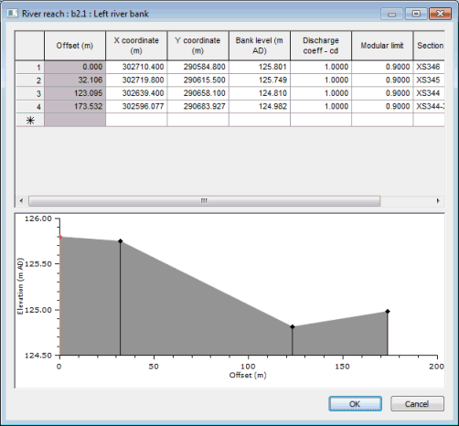

River Reach - Left river bank editor
Section points grid
Offset (cross chainage) values are automatically calculated from X and Y coordinates, but are not exported or imported when exporting to / importing from external files.

A graph of the profile of the currently selected section is displayed at the bottom of the editor.
When viewing Bridge or River Reach data; selecting points on the graph will temporarily highlight section vertices on the GeoPlan by drawing a small box round the selected vertices.
Right-click on the graph to display a context menu that includes options that allow different properties of the graph to be turned on or off.
If a ground model is loaded onto the GeoPlan Window, a trace displaying the ground model elevation can be displayed.
If results are loaded onto the GeoPlan Window, a trace displaying the water level at the current timestep will be displayed.

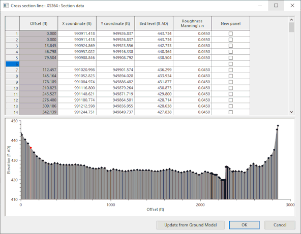

This button is only available when editing section data for a Cross Section line.
Cross section line editor
When you click Update from Ground Model,and a ground model is loaded on the GeoPlan, the cross section data is automatically updated with levels from a ground model, and an Update from Ground Model Report is displayed. A message is displayed if a ground model is not loaded.
