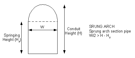

| ARCHSPRUNG |

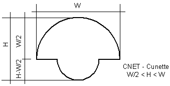

CNET |

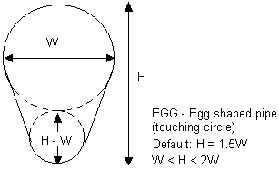

EGG |

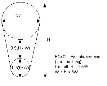

EGG2 |

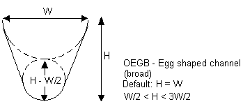

OEGB |

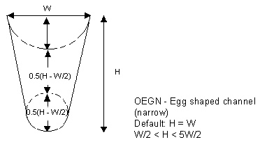

OEGN |
