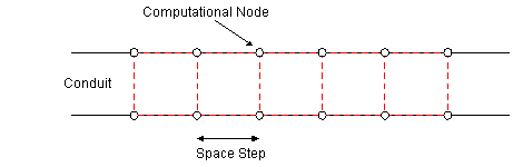

Min space step |
The Space Step parameters determine the number of computational nodes per conduit / river reach. The Space Step is the distance between computational nodes along the conduit / river reach. Valid values are: Minimum Space Step (DXMIN): DXMIN > 0, DXMIN < DXMAX Maximum Space Step (DXMAX): DXMAX > 0, DXMAX > DXMIN In addition, for river reaches:
The Space Step is determined by the Conduit width multiplier:
Minimum Number of Computational Nodes is the global minimum number of computational nodes per conduit. Controls always have 2 computational nodes. The software will allocate at least 5 computational nodes per conduit. If the number of computational nodes determined by the other space step parameters exceeds the minimum, the software will use that number instead.

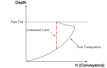

Don't linearise conveyance |
In culverts, the conveyance is greater just before the culvert becomes full than at the point when the culvert becomes surcharged. This effect is most pronounced in wide rectangular culverts, and occurs due to the effect of the roughness of the roof of the culvert. When this is option is unchecked (default), conveyance tables are linearised to the pipe full value to eliminate turning points in the conveyance function used by the solver. This is shown by the red line on the graph below. This results in the underestimation of flow capacity in rectangular culverts. However, it is more stable mathematically. When this option is checked, the simulation engine does not linearise conveyance tables (see the black line on the graph). Using this option may result in instabilities when the conduit enters/leaves surcharge.
Conduit Conveyance |

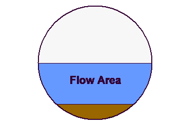

Use full area for headloss calculations |
By default the checkbox is unchecked. The value of velocity passed through to the headloss calculations is calculated from:
When this option is checked headloss calculations are carried out using the full cross section area of the pipe. |
