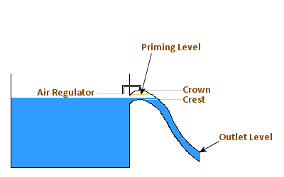

Siphon cross section
Siphon Cross Section showing levels
Schematic View of a Siphon Control in the Network
The Priming Level (or Air Regulator Level) must be between the Crown Level and Crest Level. When the average upstream water level is less than or equal to the Priming Level, the siphon operates as a weir.
When the average water level is greater than the Priming Level, the siphon is primed and flow is calculated as the lower of the flow values determined by the equations for the siphon operating as a weir and operating as a siphon.
