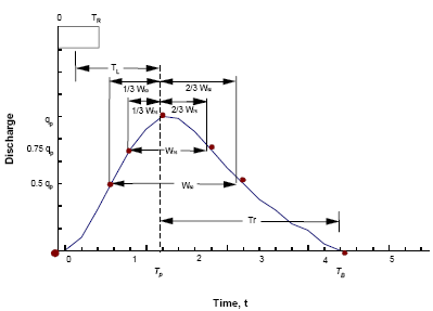

Seven coordinates can be determined from the above parameters and the hydrograph drawn through these coordinates. (The Equations section below details the calculations for each parameter.)
Snyder Unit Hydrograph Definition (diagram taken from FHWA-NHI-02-001)
In order to construct the unit hydrograpyh, InfoWorks ICM calculates approximate coordinates as detailed in the table below. The calculated base time is then adjusted until the area under the unit hydrograph is equal to 1mm.
