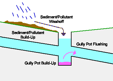

The diagram below illustrates the two processes involved in the surface pollutant model.
Surface Pollutant Model
