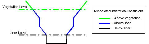

Pond Node
The Pond node allows more detailed modelling of 3d SUDS structures. The following values are input:
- Vegetation Level- Level at which vegetation starts.
- Liner Level - Level to which pond is lined.
- Infiltration Coefficients- The rate of infiltration from the pond into the ground
- Levels and corresponding Plan Area and Perimetervalues defining the shape of the pond
InfoWorks ICM calculates the wetted surface area above and below the liner / vegetation levels using Equation 2 (below) to calculate the areas of the sides of the pond, and multiplies this by the relevant infiltration coefficient to work out the infiltration losses (see Equation 1 above).
where: Al = plan area at lower point Au = plan area at upper point dH = difference in level Pl = perimeter at lower point Pu = perimeter at upper point |
As per the definition of the wetted surface area, the Base Area (Ab) is only applied to the first level of the pond.
A single subcatchment is associated with the pond node. The subcatchment area will usually correspond to the area at the highest level of the pond level-area table. InfoWorks determines direct rainfall into the pond from the current water surface area and the current rainfall rate. Rainfall that falls on the dry surface of the subcatchment is subject to the usual runoff processes (initial losses, runoff volume, runoff routing). Direct rainfall is assumed to have no losses and 100% runoff.
Evaporation is calculated by multiplying the current water surface area by the current evaporation rate.

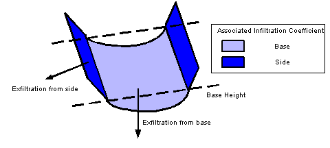

Swales
Conduits can be used to model conveyance swales. The following SUDS parameters are required to model conveyance swales:
- Base height - Height above invert of conduit. This defines the nominal base area to which the Infiltration Coefficient (base) will be applied.
- Infiltration Coefficient (base) - Rate of infiltration from the conduit base to the ground.
- Infiltration Coefficient (side) - Rate of infiltration from the conduit sides to the ground.
The use of the SUDS parameters allow flow to leave the conduit via exfiltration at a uniform rate along the length of the swale.
InfoWorks ICM calculates a loss rate based on the wetted perimeter. The loss is applied to the node immediately downstream of the swale.

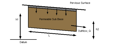

Permeable Pavements - Permeable Media Conduit
A conduit can be used to represent a permeable pavement. Setting the Solution Model of the conduit to Permeable, allows Permeable Media parameters to be set:
- Fill material conductivity- A measure of the material's ability to conduct water. Water flow increases as conductivity increases.
- Porosity - Ratio of voids volume to total volume of permeable media. Porosity directly affects the upstream and downstream depth values of the conduit. Depth varies in inverse proportion to porosity, e.g. if porosity is 30%, then the depth will be twice that of a conduit with porosity 60%.
Inflows to the permeable conduit are lateral inflows from subcatchments draining to the conduit, plus any inflow.
Outflows are determined by the conduit SUDS fields.
Discharge, Q, is calculated using Darcy's Law: rate of flow of water through a permeable formation is proportional to the change in elevation between points (Δh), the distance between the points (L) and the hydraulic conductivity (K) of the material the water flows through.
Discharge, Q is calculated as:
where: K = hydraulic conductivity A = cross sectional area of permeable formation Δh = difference in head (h1 - h2) |
