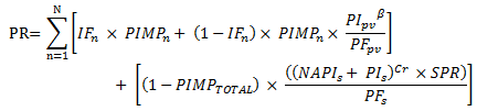

The UKWIR equation was developed as a replacement to the New UK PR Model defined previously, primarily to overcome limitations of the old equation.
The UKWIR model incorporated within InfoWorks ICM is based on the model described in A Guide to the use of the UKWIR Equation (2014).
The UKWIR equation is described below:
Where: IF - Effective impermeability factor PIMP - Percentage impermeability of the sub-catchment PIpv - Precipitation index - paved surface with rapid decay coefficient β - Power coefficient - paved surface PFpv - Soil store depth - paved surface NAPI - Antecedent Precipitation Index - Pervious surface with 30 day decay coefficient PIs - Precipitation index - Pervious surface with decay coefficient Cr - Power coefficient - pervious surface SPR - Standard Percentage Runoff (soils WRAP and HOST) PFs - Soil store depth - pervious surface |
