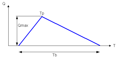

The following data is required in order to define the Unit Hydrograph:
  • Tp - time of peak flow
  • Tb - total runoff time
  • Qmax - maximum flow
Tp and Tb can be defined individually for each subcatchment. Alternatively, Tc, the time of concentration can be used to compute Tp and Tb. The time of concentration is the longest time required for a particle to travel from the watershed divide to the watershed outlet.

Qmax is then calculated via simple geometry:
(4)
