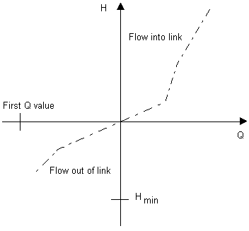

The relationship between discharge and head in the positive direction is represented as a data table of up to 15 discharge values at head values equally spaced by a specified increment. The data table applies equivalently in the negative flow direction. Intermediate values are linearly interpolated from the table. If a head larger than those defined arises, then the program extrapolates linearly from the data table using the last two data values.

When no modular limit is specified, the flow characteristics for the physical behaviour differ in the positive and negative directions and contain a hysteresis loop, the path through which depends on the direction of movement along the curve.
The governing model equation assumes the above linearisation of the hysteresis loop, resulting in a unique discharge for a given head:

The overall relationship between discharge and head in both directions is represented as a data table of up to 15 discharge values at head values equally spaced by a specified increment. Intermediate values are interpolated linearly from the table. The discharge corresponding to a head outside the bounds of the table is determined by extrapolation.
