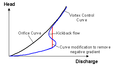

When modelling a vortex control, modification of the head discharge curve is required to remove the negative gradient in the kickback flow region.
Suggested modification to vortex control curve
