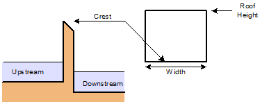

Standard Thin Plate Weir
For free discharge InfoWorks ICM uses the governing model equation based on the Kindsvater and Carter equation:
where: Qo is the free outfall discharge Cd is the discharge coefficient g is the acceleration due to gravity B is the width of the weir Du is the upstream depth with respect to the crest |
For drowned discharge InfoWorks ICM uses the Kindsvater and Carter equation where Dd is greater than zero:
where: Dd is the downstream depth with respect to the crest |
See BS3680 (Part 4A) for more information.
If the Use Villemonte equation option has been chosen as a Simulation Parameter, when the weir is under drowned conditions, the Villemonte formula is used to modify the free outfall discharge as presented in the equation below:
where: Q is the discharge Qo is the free outfall discharge (calculated using the free discharge equation above) Dd is the downstream depth with respect to the crest Du is the upstream depth with respect to the crest |
If the water level exceeds the roof height then InfoWorks ICM will use the lower of the flow values calculated by using the weir equations above and the orifice formula.

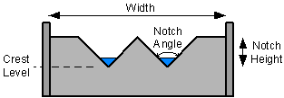

V-Notch Thin Plate Weir
Under free discharge InfoWorks ICM uses the Kindsvater and Shen formula:
where: Qo is the free outfall discharge g is the acceleration due to gravity Cd is the discharge coefficient. In InfoWorks ICM, this value is fixed at 0.585. This is correct for 90° notch weirs. θ is the angle of the notch Du is the upstream depth with respect to the crest |
The weir is assumed to be drowned if the downstream water level exceeds the crest level. The Villemonte formula is then used to modify the free outfall discharge. See Equation 3 above.

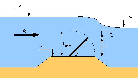

Gated Weir

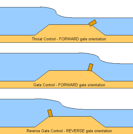

Three flow regimes can be used to model for flow over a gated weir:
- when the gate is lowered and the weir operates as a flume or broad crested weir with critical depth in the body of the structure.
- when the gate is raised and critical depth occurs at the gate crest.
- when the direction of flow is from the free crest towards the hinge when performance is similar to a weir with a triangular profile.
These are shown on the diagrams below:

If the level on both sides is below the gate crest, then the following equation is used:
Equation |
Q = 0 |
Determination of throat/gate and free/drowned flow combinations
m = Modular Limit
b = Breadth of sluice at control section (normal to the flow)
Ctc = Discharge coefficient for throat control
Cgt = Discharge coefficient for gate control
Crev = Discharge coefficient for reverse gate control
Flow is determined to be throat flow if |Qthroat| < |Qgate| and gate flow otherwise. Throat Flow:
Gate flow:
To determine whether flow is free flow or drowned flow:

The equations and conditions are the same as for the forward flow combinations (described above) but with reverse flow (Q<0). Note that the orientation of the gate specified for reverse flow combinations is relative to the crest, not the flow direction, e.g. for 'Free weir flow - reverse gate, throat control, reverse flow', the position of the gate is not physically oriented the same as for 'Free weir flow - throat control'. For 'Free weir flow - throat control' and 'Free weir flow - forward gate control, reverse flow', the gates are in the same position, relative to the crest.
- Free weir flow - reverse gate, throat control, reverse flow
- Drowned weir flow - reverse gate, throat control, reverse flow
- Free weir flow - reverse gate control, reverse flow
- Drowned weir flow - reverse gate control, reverse flow
- Free weir flow - forward gate control, reverse flow
- Drowned weir flow - forward gate control, reverse flow
