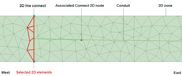

To associate a Connect 2D node with a 2D line connect object, ensure that the node's Node type is set to 2D, its Connection type is set to 2D line, and that the relevant 2D line connect object is selected in the 2D connect line property. A 2D line connect object that has been associated with a Connect 2D node is represented on the GeoPlan by a dashed green line (part of the 2D line connect default theme) between the centre of the 2D line connect object and the Connect 2D node. This is shown in the Example of 2D element selection below.

Selection of the 2D elements to be included in the flow exchange calculation is determined by the direction of the two last vertices of the conduit that is connected to the Connect 2D node. For example, if the direction of the last two vertices of the conduit is east to west, as shown in the following example, then only the 2D elements on the west side of the 2D line connect object are selected for use in the calculation.
