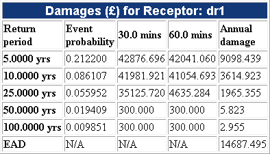

Tables of damages
| Column | Description | |||||||||||||||||||||
| Return period | Return period of rainfall event | |||||||||||||||||||||
| Event probability |
Probability of event occurring. The probability of non exceedance of a given return period is calculated using:
where: RPi is the return period under consideration. The Event probability is calculated by discretising the probability of non exceedance curve, where the Largest zero-damage event return period, specified in the Risk Analysis Run View gives the probability for zero damage. For example, for a risk analysis using events with return periods 2, 5, 10, 25, 50 and 100 and a largest zero-damage event return period of 2:
| Event duration | Worst case damage calculation values for each storm duration for given return period. | |||||||||||||||||||||
| Annual damage | Annual damage for a return period is calculated by multiplying the largest of the damage values for that return period by the Event probability for the return period. |
