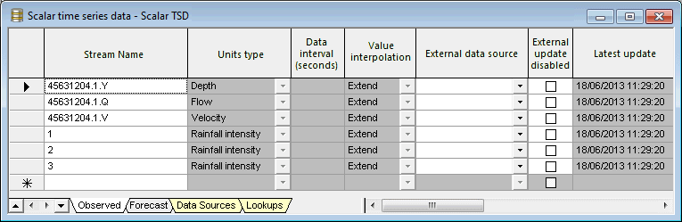

A scalar TSD consists of a number of streams and related external data sources. A stream defines a single series of time varying data and its properties.
An example of a configured scalar TSD

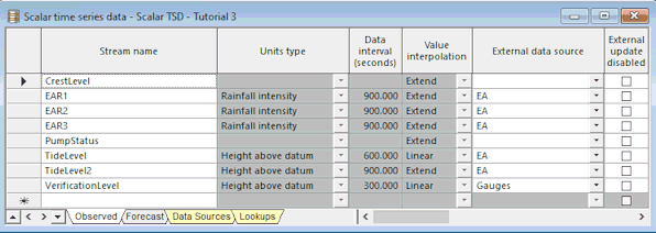

The Observed and Forecast pages contain information about observed and forecast streams respectively. The Data Sources page contains details of the corresponding external sources while the Lookups page is used to map alphanumeric text, in the imported time varying data, to numerical values which are recognised by InfoWorks ICM.
There are two types of stream: observed and forecast. Observed streams record real world measured values whereas forecast streams record predicted values.
The following stream properties apply to both observed and forecast streams unless otherwise stated:

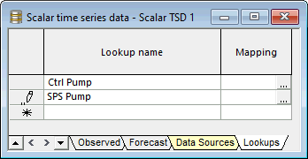

Lookup name |
The name of the lookup table, as defined on the Lookups page. |

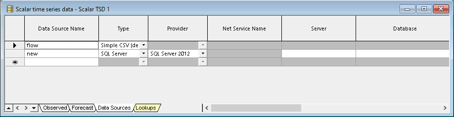

Data Sources page
Data sources are required to connect to external systems to get the time series data for the streams. For example the folder name where RADAR forecast data is stored or the connection string required for a RDBMS such as Oracle.
| Field | Description | ||||||||||||||||||||||||||||||||||||||||||||||||||||||||
Data Source Name |
User defined name for the connection. |

When setting up the data source details in the Scalar TSD object, the path of the folder in which the files with the data stream feeds are located is specified in the Filename/Foldername field of the Data Sources grid. This allows one data source to be specified for a set of streams.
By default, when updating data streams from external data sources, InfoWorks looks for a file in the Data Source Filename/Foldername field called <Stream Name>.txt. However, this behaviour can be overridden by specifying a filename, including the filename extension, in the Table field of the Observed grid for the stream. (InfoWorks will still look in the same folder defined in the data source for the specified file.)

Lookups page
Some imported time varying data is received in alphanumeric text format, and in order for this to be recognised by InfoWorks ICM, it must be converted into numerical values. This conversion is carried out according to the mapping defined in a lookup table, which can subsequently be assigned to a data stream in the Observed and Forecast pages.
Lookup Name |
User defined name for the lookup conversion table. |
Mapping |
Click
