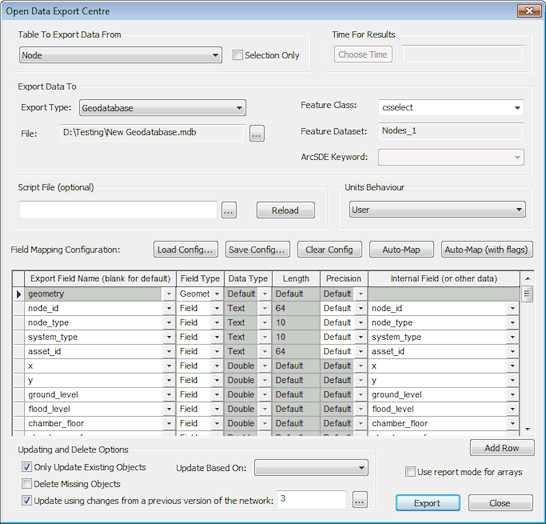

  1. In the Open Data Export Centre Dialog select the InfoWorks ICM table to be exported from the Table To Export Data From dropdown.
  2. Select the Oracle option from the Export Type dropdown in the Export Data To section.
  3. Use the File browse button to connect to an existing database. The Select Oracle Data Dialog will be displayed.
  1. In the Select Oracle Data Dialog, connect to an existing database, select the user tables to view and click OK.
  2. In the Open Data Export Centre Dialog, type in the name of a new Feature Class to which the data is to be exported.
  3. Map InfoWorks ICM internal fields to Feature Class export fields by loading a configuration file or by manually mapping the fields in the Field Mapping Grid.
  4. Click the Export button.
The specified Feature Class will be created and InfoWorks ICM data will be exported to it.

  1. In the Open Data Export Centre Dialog, use the File browse button to connect to an existing database. The Select Oracle Data Dialog will be displayed.
  2. In the Open Data Export Centre Dialog, select an existing Oracle Database Feature Class from the Feature Class dropdown list. The Updating and Delete Options section will become enabled.
  3. Map InfoWorks ICM internal fields to Feature Class export fields by loading a configuration file or by manually mapping the fields in the Field Mapping Grid. In the Field Mapping Grid:
    • Red indicates items in the Export Field Name column and Internal Field column that are mapped as update keys
    • Italic font in the Export Field Name column indicates fields that do not exist in the selected Feature Class.
    • The Export Field Name column contains a drop list of only the field names from the selected Feature Class. Entering a non-existent name specifies a new field name.
  4. Map update keys - select the fields to be used to locate items for update in the specified Feature Class. The Update Based On dropdown list contains all update mapping options applicable to the current Table to be Exported:
    • Asset ID - the Asset ID field is used to locate row objects in the specified Feature Class.
    • InfoWorks ICM Primary Key Fields e.g. Node ID for node objects; US Node ID, Link Suffix for link objects. The Primary Key Fields are used to locate row objects in the specified Feature Class.
  5. Set Only Update Existing Objects option:
    • Check the Only Update Existing Objects box to restrict update to objects that already exist in the specified Feature Class. If this option is unchecked, any objects in the InfoWorks ICM table to be exported that do not match objects in the Feature Class will be added to the Feature Class.
  6. Set Delete Missing Objects option:
    • Check the Delete Missing Objects box to search for missing objects and delete them from the target database at the end of the export process. (A missing object is an object that is in the external Data source table, but is NOT in the InfoWorks ICM Table to Export Data From.)
    • The update key selected in the Update Based On dropdown will be used to search for missing objects.
    • All missing objects found will be listed and a prompt for confirmation of deletion will be displayed before any objects are deleted.
  7. Set Update using changes from a previous version of the network option:
    • Check the Update using changes from a previous version of the network box to compare the current version of the network with a selected previous version of the network. Differences in objects, identified by the comparison, will be applied to the external data table.
  8. Click the Export button to export data from InfoWorks ICM to the specified Feature Class. All fields, except mapped update keys will be updated in the Feature Class.
