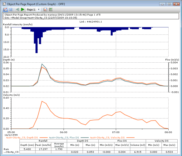

An example of the simplest graph type:
An example of a more complex report:

Multi page reports
Some more complex graph reports may contain more than one page. If the report contains more than one page, as seen in the example of a more complex report above, then you can scroll through the pages using the pgup and pgdn keys.
Note: This functionality is not available for Custom Graphs as the different pages can be accessed via the and buttons of the toolbar.

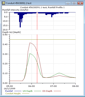

Moving to a different simulation time directly on the graph
On graphs produced by the Pick Graph tool or the Graph Selected Object tool only, the red time line shows the current time of the simulation, mirroring the current time of the simulation on the Geoplan. To jump to a different simulation time, you can drag and drop the red line to the desired simulation time directly on the graph. The simulation date & time will be updated accordingly on the Geoplan.
Right-click on the graph view and select Auto-label traces from the context menu to display a label showing the value of the trace at the current time of the simulation.
Run origin line
On graphs produced by the Pick Graph tool or the Graph Selected Object tool only, the blue time line shows the run origin time of the simulation.
