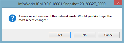

When you open a network that has changes that have been committed by others, but your local copy of the network has uncommitted changes, the following message is displayed:
Select:
- Yes to update your local copy of the network with the committed changes from other users and open it on the GeoPlan.
- No to open your local copy of the network on the GeoPlan without updating it to include the latest committed changes from other users.
- Cancel to cancel the open network operation.
If your network does not have any uncommitted changes, then InfoWorks ICM automatically updates your local copy (if committed changes have been made by others) when it is opened on the GeoPlan.
