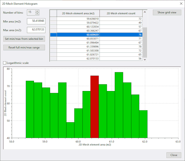

To generate a histogram, ICM uses the largest area of all 2D mesh element areas in the selected 2D zones as the initial maximum 2D mesh element area, and assigns 0 as the minimum area. It then subdivides the initial maximum area into equal-sized intervals (bins). By default, the number of bins is 10. It then finds the number of elements for each binned mesh area, and displays them in a dialog as the 2D mesh element area/2D mesh element count histogram and grid. An example is shown below:
Both the grid and the histogram are selectable. If you select a row in the grid, the corresponding bin is highlighted in the histogram. Similarly, you can double-click on a bin in the histogram to select the corresponding row in the grid.

The 2D Mesh Element Histogram dialog is displayed, which contains the 2D mesh element area/count histogram and grid based on the initial minimum and maximum area and number of bins.
