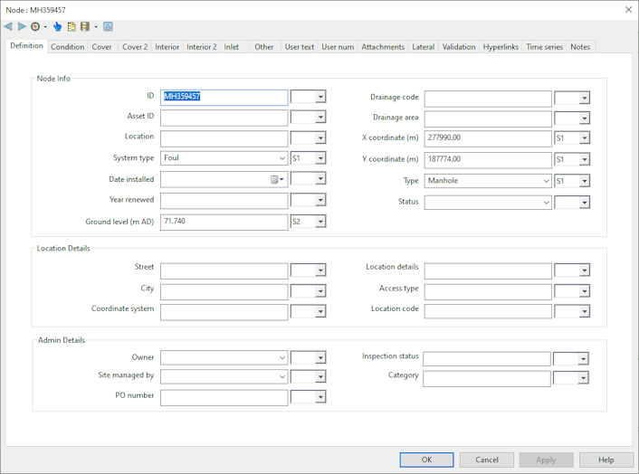

Tabbed Property Sheets
Applicable for asset network objects only.
To display tabbed property sheets for asset network objects, ensure that the Use property editor for asset network objects option is unchecked on the General Page of the Options dialog.
The data is divided up into pages or tabs showing data of similar type. Some data is common to more than one type of object, so a page may occur on more than one type of Property Sheet.
Most tabbed property sheets are modal. Work cannot be carried out elsewhere in the InfoWorks ICM interface until the property sheet is closed. Some property sheets do allow users to move to other parts of the interface and carry out other work. The property sheet remains visible but the title bar turns grey to show it is inactive.

Tabbed Property Sheet |
In Object Properties Window |
When editing data on a property sheet, many controls will have an associated flag control immediately to their right. Select the appropriate flag from the dropdown list and both the data and flag controls will be redrawn in the correct colour.
