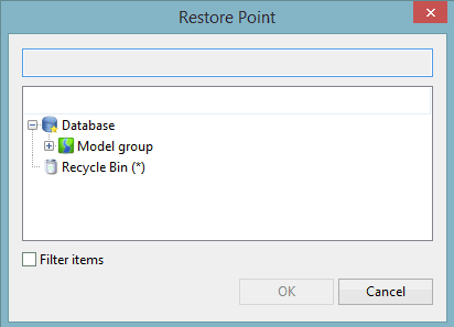

The items are restored in order of their position in the database hierarchy, with the highest level items restored first. This means that they are then available as restore points for subsequent descendant items.
A message is displayed if you attempt to restore an item whose parent has either been permanently deleted or is currently in the recycle bin but is not selected to be restored. Click OK and a new window is displayed enabling you to choose a different restore location.
Select the required location from the available options and click OK to restore the item to the selected location. Both the current item and any subsequent orphaned items with missing parents of the same type will be restored to the selected restore point.
