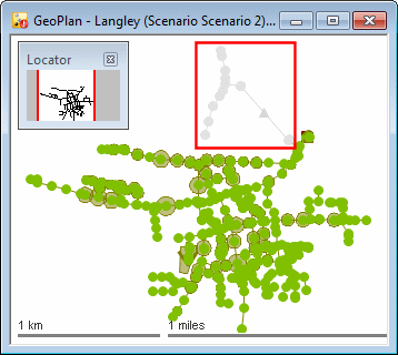

Network objects present in the base network but not in the current scenario are displayed as a faded grey colour in the scenario GeoPlan window. Display of these 'object ghosts' can be turned on/off from the Visual Page of the GeoPlan Properties Dialog.

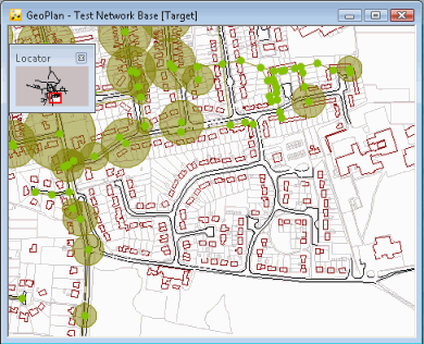

A new housing estate is planned in the south-east of an existing town. A feasibility study is to be carried out to assess options for connecting the new estate to the existing sewer network.
The base network is the network in its current state. The background map shows the plans for the new estate, and currently there are no nodes or links serving it:

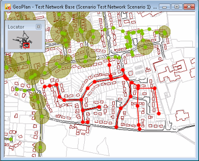

Scenarios can be used to model new estate connection options.
A scenario is created for each option to be assessed. An example is shown below:

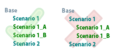

- Scenarios can be created from a base network. Any subsequent change to the base will cascade down to the scenarios.
- It is also possible to create copies of scenarios. This is equivalent to the Copy/Paste operation that computer users are accustomed to using, i.e.:
- Copied scenario are duplicates or direct copies of the scenario they originate from.
- Copied scenarios are independent from the original scenario.
- Scenarios that are copies of the same scenario are not linked in any way. Changes made to the original scenario do not cascade down to the scenario copies.
If we take the example below, where two scenarios, Scenario 1 and Scenario 2 have been generated from the base. Scenario 1 and Scenario 2 are independent from each other. However, changes made to the base will be cascaded down to both scenarios.
Scenario structure
Scenario 1_A and Scenario 1_B are duplicates of Scenario 1, and were obtained by copying Scenario 1. Scenario 1_A and Scenario 1_B are independent from each other. Making changes to Scenario 1_A will have no impact on Scenario 1_B and vice-versa. Similarly, editing or even deleting Scenario 1 will have no influence whatsoever on Scenario 1_A and Scenario 1_B. This is why the structure of scenarios can be represented by the image on the left (green tick) rather by than the one on the right (red cross).
